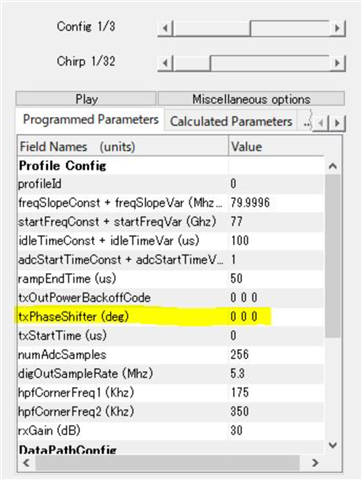

We have attached the result. In the attached screenshot, although we expected phase shifts to be applied, the phase shift values for all TX antennas remain “0” across all chirps.

    (For example, as shown in the attached screenshot, is it not possible to determine whether the phase shift is working correctly just by checking the “txPhaseShifter(deg)” values?)
We do have access to evaluation equipment such as a radar target simulator, but it is not readily available for use at the moment. Therefore, we would like to know if there is any way to verify the phase shifts using only mmWave Studio.

    I would not trust the phase information listed in the postProc figure below.  It may have some limitations.   Did you process your data and checked the real and imaginary part of the signal for different chirps and did you observe any change?  One suggestion from me is to program the chirps to use the same TX, and just change the phase shifting value, to see any relative change in phase cross different chirp.
    Thank you very much for this valuable suggestion. I will configure the system to use simultaneous transmission from all TXs while varying only the phase shift values. I plan to apply this configuration and conduct measurements in an anechoic chamber at a later time.
