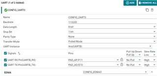

Although I modified the syscfg settings of the motion_and_presence_detection software( mmwave_l_sdk_05_04_00_01)  as described below, the device could not be woken up via UART.
Are there any additional changes required to enable wakeup from deep sleep via UART? Or are there any limitations, such as UART B not being supported for this function?
UART setting is below.
Thanks.

    The UART wakeup is only triggered by wakeup on UARTA. If you are using the EVM (AWRL6432BOOST), we can only configure UARTB since UARTA is either always connected to the XDS110 or CAN interface on our EVMs. If you had your own custom board, then you would be able to free up UARTA to allow it to trigger the UART wakeup.
