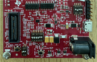

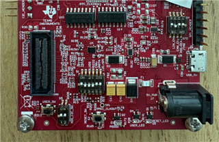

       The model of the development board I use is IWRL6432and the Boost version is RPOC17 REV.B.

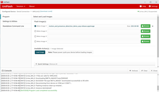

        1. The development board is flashed with the firmware "radar_toolbox_3_10_00_05\source\ti\examples\Out_Of_Box_Demo\prebuilt_binaries\out_of_box_L6432.appimage".
         After flashing the device, the version number of the firmware can be displayed on the serial port. Then,

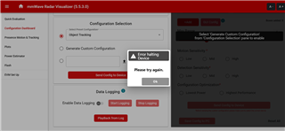

         I sent the following configuration information to the development board through visualizer and obtained the commands that the firmware does not support (as follows txt).

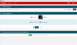

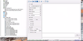

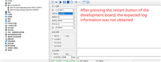

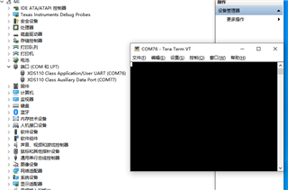

         2. I brushed "radar_toolbox_3_10_00_05\source\ti\examples\Industrial_and_Personal_Electronics\mmWave_Demo\prebuilt_binaries\mmw" on the development
         board After the firmware "ave_demo_xwrl6432.appimage", when the development version is switched back to "application mode", the DC input power supply is 5V3A,
         but no information is obtained from the serial port (similar to the version information in 1).
         Based on scenario 1, I analyzed that my development board should not be damaged, but I can't run the program on this fast development board now. Please help me.
