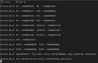

    I tried changing RANGE_BIN_END to 20 so that the device could detect gesture features around 100 cm away, as shown in the image.
    However, I encountered an error. Below is the message I saw during debugging with JTAG.
    I suspect the problem might be that the RANGE_BIN interval is too large for the device to handle.

  • Hello Haoyu,
    Unfortunately that error message is not very helpful for debugging the issue, it just indicates the device is crashing at some point. Can you try placing breakpoints at different points in the code and stepping through to identify where the crash is happening.
    I might expect this crashing behavior when increasing the number of range bins processed as you mentioned but if you see the same issue with less range bins there may be a different  issue.

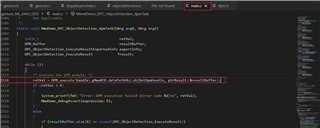

  • Hey Josh,
    I set some breakpoints and noticed that when RANGE_BIN is between 15 and 20, things break right after DPC_ObjectDetection_execute finishes and we go back into main.c to run DPM_execute. Since I can’t peek inside DPM_execute, I don’t know exactly what’s going wrong. On top of that, every time I debug, the crash happens at a different spot, so it’s really tough to pin down the exact culprit—I just know it’s somewhere in MmwDemo_DPC_ObjectDetection_dpmTask.

  • Hello Haoyu,
    Thank you. Based on the behavior you describe it does seem like it is running out of frame time before completing the processing.
    After taking a look at the gesture recognition code I think the issue is likely due to some inefficiencies/bugs in the feature extraction part (gesture.c). For example in Computefeatures_DOABased(), there is a for loop which searches through rangeBin = 0 to RANGE_BIN_END, but I believe it only needs to be from RANGE_BIN_START to  RANGE_BIN_END, This would cause the additional processing time even when the actual interval of range bins specified for feature extraction is less than the default. Can you try changing this so the loop begins at RANGE_BIN_START?
    Similarly, the Computefeatures_preStart() zeros out the doppler bins close to zero doppler for all range bins but again this likely only needs to be done for the range bins of interest.
    Josh
