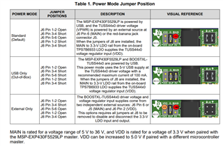

Hey there,
I have tried the different power modes of the EvalBoard BOOSTXL-TUSS4470. For the external Power I have tried 5V, 8V, 12V, 20V and finally 31V to max out the response of the Transducer Signal. After increasing the voltage, the board was not responding anymore at the last step.
Is there any critical component or problem which can occur due to that voltage? I thought the max voltage should be at 36V (printed at the board and datasheet).
I flashed the LAUNCHPAD MSP430F5529 EVAL again but only have the IO1 and IO2 Pins on 0.
