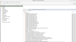

Dear contact person,
                                       I am try to build iwr1443 high accuracy firmware in code composer studio but not able to build, it shows many errors. Attaching the screen short.
Abhijeet Singh
  • Hello Abhijeet.
    It looks like you have posted multiple threads about this issue; if so, were you able to resolve your issues in this thread?  Please let us know so that we can close the duplicate threads and only have one open thread regarding this issue.  From the screenshot above, it looks like certain libraries that would be included in the SDK are not being found; have you made sure that the SDK is being included by the project or that the SDK is being recognized by CCS?
    Sincerely,
    Santosh
  • i am going with these thread and please help me to resolve the issue , whose screenshot is attached
    Have you tried the same in windows os? Let me take a look in the meantime
