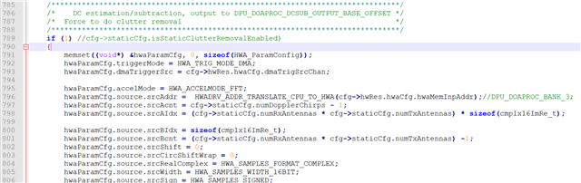

    One way is to change the clutter removal method.  Instead of remove zero Doppler bins, you can use DC estimation and subtract from the signal.  We have such an implementation in in-cabin demo located at:
    radarToolboxFolder\source\ti\examples\Automotive_InCabin_Security_and_Safety\AWRL6432_Life_Presence_Detection_Demo_Capon2D\src\xwrl6432\datapath\dpu\doaproc
    function: doaProc_configHwa_fft
    The first two paramSet is used for DC estimation and DC subtraction.

    I will use DC estimation and subtract it from the signal instead of removing zero Doppler bins.
