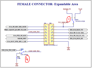

is it possible to break off the sensor part of IWRL6432AOPEVM and still use it by connecting a 12-pin cable between J8 and J9?
This would allow more flexible placement of the sensor for evaluation.
Looking at the datasheet, it seems like this is not supported. The 12-pin connector has only 3.3V supply, while the device needs 3.3V and 1.8V supply for operation. Can you confirm this or direct me to corresponding documentation that shows how to operate the device just from 3.3V?
The 1.8V DCDC seems to be U20, which is located on the debug part of the EVM.
