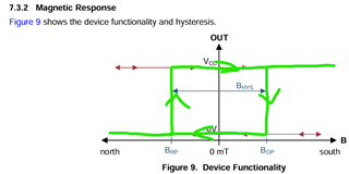

is Texas planning to release the DRV5012 with an inverted Output as shown below.
Weird question, sorry. Thanks :)
  • Just wondering as many Sensors exists in all flavors and the DRV5012 has no derivates.
    Obviosly i could implement the inverting logic in the circuit, but out-of-the-box would be better.
  • Hello Eld,
    Its not currently on our roadmap.  However, if you would like to share details on what you plan to do with it, we can assess whether it is something we might consider providing in the future.  You can send me a private message if you want to pursue that option yet dont want to share your details in the public forum.

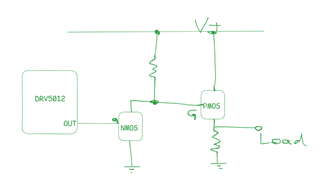

  • Hi Patrick,
    application would basically be:
    The output of the DRV5012 is connected to the Gate of High-Side P-Channel MOSFET, which switches the load on/off depending on North/South.
    The desired behavior would be:
    NORTH -> Load off (DRV5012 output high);
    SOUTH -> Load on (DRV5012 output low)
    Which is the opposite behavior of the DRV5012.
    The workaround is a inverting logic with MOSFETs, except you have a better idea (?):
    Best regards
  • Hey Eld,
    Thanks for sharing that, I will pass it along.  As of now I dont have a workaround for you, but I think on it a little and see if I can provide feedback on Monday.
  • Hey Eld,
    That definitely is one way to get your desired behavior. To save on space, maybe you can find those mosfets in an integrated package like DMC31D5UDAQ-7B.  Alternatively, perhaps a Not Gate like the SN74LVC1GU04 could be used.
