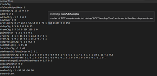

    The ADC sampling rate is not fixed at 37.5 Msps, it's max sampling rate is 37.5 Msps. What do you mean by beat frequency? But yes, you can change the sampling frequency in the .cfg file that you load onto the board.
    The following is an example configuration. The ADC sampling rate is 13,349(ksps) in this example. You can change it as long as you do not go over the max sampling rate.
    Gabriel
