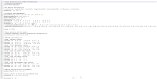

I’m still encountering an issue: seats C and D are not being properly classified when a car seat is involved.
For reference, here is the snippet for seat D with a rear-facing child seat:
This is my updated configuration file:
I am not sure how else to fix this.

  • Hi, Kevin:
    Please adjust the zOffsetCfg in the CLI comment for each seat.
    Zigang

  • Hi, Kevin:
    About baby rear facing case, do you see a lot of point cloud, just not enough to trigger the occupancy decision, or the point cloud is too limited.
    1) Maybe you can try a different car seat, or adjust the mount slight backward and higher (if possible).
    2) you can make the zone bigger to start with, baby rear facing case can introduce some multipath, it is good to include these multipath.  So modify the zone bigger to see whether more point cloud can be detected. (note that only the point cloud within the zone are displayed in the visualizer).
    3) You can also adjust the CFAR parameter, try a larger guard interval, and try a smaller CFAR threshold.

  • Hello Zigang,
    Wow, you nailed it! most if not all of the problems that I was having are resolved! thank you for your intuition.
    on the other hand, there is this odd issue that I get whenever I have an object on the driver's seat. the sensor seems to overpopulate with a bunch of noise only when there is a baby doll on the seat. it's weird because whenever I do not have anything on the seat there is no noise. I would assume that this is because I adjusted the point cloud detection too much.

  • Hi, Kevin:
    Is it possible to let me know which suggestion helps and what is your CFAR setting for now.  Those out of zone point cloud are usually due to the multipath.  For your attached the figure, do you have a baby in the driver seat?  It could be the driver seat causes a lot of multipath that can show in the seat 3.  If you tilting the driver seat down, you may see the detected points in seat 3 reduce dramatically.
    Zigang
  • Hey Zigang,
    Of course, here is a snippit of the CFG file of my current working settings. The changes that helped in order to distinguish the car seat facing rearwards were creating a bigger box for each seat. I actually changed the X-axis to make it bigger. this seemed to help a lot. I would say that the pre-set zone definition that I originally had wasn't really good.
    I see, the baby is sitting in the driver's seat, and I do notice that this causes some noise from what the multipath effect might be. regarding the seat tilt, do you mean tilting the seat back? and would I have to re measure this and implement it to the CFG file?
