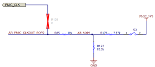

AWR1843AOP: PMIC_CLKOUT NODE (series resistance 10K)
Part Number: AWR1843AOP
The EVM board is designed with a series resistance (10K) inserted in the direction of PMIC_CLKOUT NODE, followed by a 3.3V voltage distribution (7.87K at the top/ 82.5K at the bottom).
On its board, it is designed with 3.3V voltage distribution (the top 7.87K/the bottom 82.5K) without serial resistance.
Is there no problem without serial resistance in the design?
