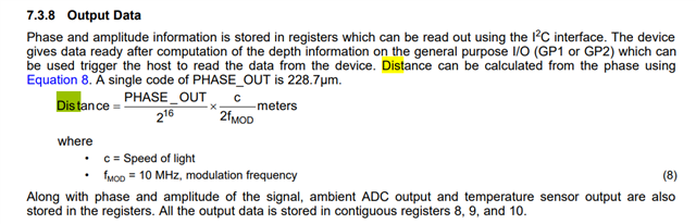

Is there an algorithm module for measuring distance?
Hello Gareth,
The OPT3101 is optical's only supported ToF sensor.
To determine distance from output of sensor you simply plug the output (PHASE_OUT register value) into the below equation.
