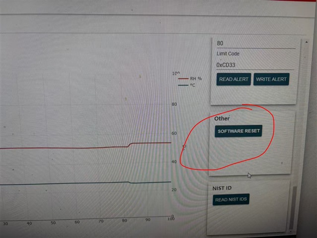

    I let customer try with TI HDC3020 EVM. However, I cannot find button to control "enable heater" and "disable heater" which should be at "Other" group according to user guide. Could you help on this?

    The heater enable and disable buttons are visible on version 1.0.7 of the GUI, not on earlier versions. I was able to find that version without logging in to a TI account, but to use it requires a TI account. I have disabled that, so it should be available to anyone now.
    Now when you click enable heater, it will run at default heater power, which is not very strong.  There is not a way in the GUI to just send a particular configure command to change the heater power, but there is a workaround you can use to get the heater to max power.
    • first, go to the drift correction section and ensure the drop down is set to high power
    • Then, hit execute. The heater will turn on to high power. The user can then hit abort or let the drift correction sequence finish. The idea with the drift correction is to provide an offset code that can be programmed in, but we will ignore that.
    • now, the heater is off, but the high power code was loaded into the sensor when we hit execute. So now, when the heater is enabled and disabled with the previous buttons, it will operate at max power.
