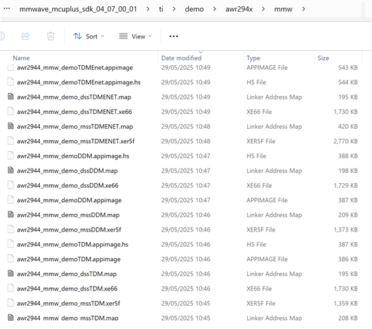

I am using the uart_uniflash.py script to flash created binaries onto an AWR2944EVM created as instructed on P.41 of  "MMWAVE MCUPLUS SDK User Guide" though the flushing was successful, the documentation does not answer some of my questions. Therefore I hope that you can help with that:
  • The documentation states: "This will create <mmwave_sdk_device>_mmw_demo_mss.xer5f, <mmwave_sdk_device>_mmw_demo_dss.xe66 & <mmwave_sdk_device>_mmw_demo.appimage binaries", however gmake all created a multitude of files (see Image). I am curious why so many files were created? Is this typical only for the demo code to create TDM, DDM and other version of the 'same' demo code?
  • As I understand the AWR2944EVM needs to get both the C66x and R5F flashed, these are the binaries that are created upon compilation of the demo code files. However the default.cfg file does not contain any paths to the binaries for the C66x and the R5F. To my understanding the meta image (, i.e. the .appimage) contains these paths, is this correct? If so which of the multitude of the created files are these? Is there a possibility to view the internals of the .appimage and explicitly check the used/referenced binary files?
    1) To answer your first question, these are all files made for different purposes. There is DDM & TDM which are different demos. Enet is for ethernet demos. .map files are to observe the memory allocation used for that specific demo. If you are wondering about specific ones, ask and I will answer. Yes, it is very typical to build all these files.
    2) I believe you have a slight misunderstanding here. The .appimage is what is flashed on using default.cfg. Those core files (.xerf5, etc.) are loaded using CCS. This is done usually when more debugging is desired.
    Let me know if you have any further questions.
    Gabriel

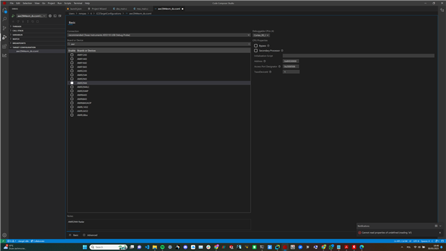

    So now I do understand the layout of the SDk but I have an issue, it seems that the new version of the CCS has a very different layout than the one that you have refferenced and that the documentation https://dr-download.ti.com/software-development/software-development-kit-sdk/MD-U4MY7aGNn5/04.02.00.02/mmwave_mcuplus_sdk_user_guide.pdf .
    More precisely I have created a new target configuration, here I am unsure what about the additional settings which seem to be absent in the previous version mentioned in the SDK documentation:
    Critically I cannot manage to launch this target configuration, the CCS documentation https://downloads.ti.com/ccs/esd/documents/users_guide_ccs_20.1.1/ccs_debug-main.html?highlight=target%20configurations#target-configuration-files doesn't really describe how to do that besides the structure of the file itself.
    Could you give me guidance how to get these 2 steps done with the new CCS 20.1.1?
    Please use version 12.8.1 for now.
    Gabriel
