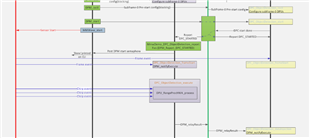

   I have captured  raw adc data using AWR6843ISK+DCA 1000  card and  captured data is stored in .bin file.
I want to Run the out of box demo with this RAW ADC data from  .bin file instead of "Front end data coming Via ADC buffer"  and run the complete example and visualize the output.
As per my understanding the following step need to   be done :
1. .bin file data need to stored and Mapped
2.mmwave_start step code need to be bypassed in the below timing diagram,but this can lead to not generating frame_event and chirp_event trigger causes further code not running.
i have already referred the below thread
https://e2e.ti.com/support/sensors-group/sensors/f/sensors-forum/1446873/awr6843isk-how-to-use-captured-bin-file
but i could not get  understand  logic of " need to simulate a chirp available ISR so that the rest of the signal chain can work as normal".
My question:
  1. how to use Captured bin file Raw adc data instead of "Front end data coming Via ADC buffer" and execute entire Example Chain?

  • Hey Mani,
    For simple variables that are utilized infrequently during DPC execution, you could print to the debug console using System_printf. For arrays, you could use fwrite to write the data to a binary and then look over the data afterwards. However, there is a chance that adding printouts or writing to a file will violate the timing constraints on the ARM side still.
    You could theoretically comment out the DPC_Objdet_Assert on line 645 which would prevent the ARM core from aborting, though this will introduce unexpected behavior and may inject incorrect data into the processing chain.

  • Hey Mani,
    You can simulate a chirp available through the usage of the EDMA by initiating a transfer (EDMA_startTransfer) to channel ID EDMA_TPCC0_REQ_DFE_CHIRP_AVAIL of channel type EDMA3_CHANNEL_TYPE_DMA. This requires some additional configuration on the EDMA side which can be seen in the range processing test (packages\ti\datapath\dpu\rangeproc\test\hwa_main.c).

    if i want to implement "reading data from bin file and EDMA_startTransfer as suggested by on "TI  OUT of BOX "example (C:\ti\radar_toolbox_1_30_01_03\source\ti\examples\Out_Of_Box_Demo\src\xwr6843ISK).
    my question :
    1. will it work without any issue directly?
    2. Do i need to comment any function /API on the existing Code to aviod RF front data transfer/flowing to DPC processing chain?
        if i have to comment ,please let me know steps or function to be commented or to follow any reference example available.
    mani
  • Hey Mani,
    See my comments below.
    I do not know for certain as that will depend on how you integrate the relevant EDMA code. For example, you could set up a separate adcFileReadTask which is triggered upon receiving sensor start and reads in an ADC data file - similar to what we have in MMWAVE-L-SDK.
    You would need to comment out MmwDemo_startSensor within mmw_cli.c since we don't want the sensor starting and populating the ADC data buffer.
    Kristien

  • Hey Mani,
    1.if i comment out MmwDemo_startSensor ,does the remaining processing chain will work, without any issue?
     2. else ,what changes do i need to add in the code ,to run the further processing  without any issue?
    3. if similar approach is done on "MMWAVE-L-SDK",can please share the details on which file /part of which function got implemented?
    As described previously, you will still need to simulate a chirp available through the EDMA and should add in a task or function to pull in the captured ADC data. I would highly recommend reviewing the CLI_MMWStart function from the MMWAVE-L-SDK - equivalent to MmwDemo_CLISensorStart from SDK3 - under <MMWAVE_LSDK_INSTALL_DIR>/examples/mmw_demo/mmwave_demo/source/mmw_cli.c and the adcFileReadTask under <MMWAVE_LSDK_INSTALL_DIR>/examples/mmw_demo/mmwave_demo/source/test/ADC_testbuf.c to understand how raw ADC data is fed in on the low power platform. Most of the code should be portable to SDK3, though you may need to find equivalent SDK3 functions or features for some of the LSDK functions.

    So as per my understanding the following steps need to be done to read adc  data from file instead of Rf front end..
    1.need to comment execution of mmwave start--which stops the sensor start,but this will lead to not generating any frame event and chirp event by Rf front end..
    2.read one chirp of  raw adc data from bin file and write into adc buffer memory address..
    3. I need to simulate frame event and chrip event by invoking necessary API/command  EDMA_startTransfer as you mentioned in your previous reply..
    My question:
    1.please correct me, my above understanding is correct or any other steps i missed it?
    2.please confirm using of "EDMA_startTransfer command generate chirp event or it does transfer of data from ADC buffer to HWA internal memory using   EDMA for processing or both ?
    3.if EDMA_startTransfer command generate chirp event then do I need use/invoke  this command equal to number chirps used in the processing  or need to invoke only once itself sufficient?
    4.if  EDMA_startTransfer command  does not do the transfer of Adc buffer data to HwA internal memory...then using which command or routine I  can transfer  the data for processing?
    5.and also confirm, first  adc buffer data need to be moved to hwa memory  then chrip event need to be generated or first  chirp event will be generated them adc buffer data will be moved to hwa memory?
