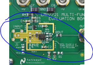

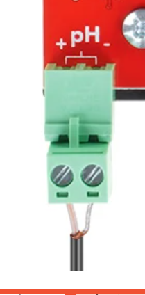

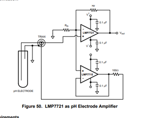

We are working on a pH sensor board with the following requirement
Below is the requirement
Can you please suggest opamp and adc
Also, If any eval kit available for testing
Also, Please share any reference PCB Design guidelines for pH sensor routing related
Requirement:
pH sensor accuracy: ± 0.1 pH
Resolution: ± 0.1 pH
pH electrode’s output impedance: 10 Mohm to 1000 Mohm (Typical for pH electrodes)
Amplifier’s input impedance: >1 Tohm
