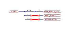

Hello! I am trying to create a list, or matrix of of connections between the two HDR60 connectors, J10 for the DCA1000 connection and J4 for LVDS and JTAG. I'm trying to establish which connections could be connected straight through, EG presumably RADAR_DP0-7 can be "jumped" or shorted together, skipping any additional circuitry on the BOOST board. However, which (if any) of the other connections can be connected 1:1, are required for the proper operation of the LRU connected to J4, and/or are unnecessary/incompatible with one another (EG J10.13 PGOOD is not a direct matchup with J4.14 60PIN_PGOOD_3V3)?

    Considering the signals that are shared by J4 and J10 and have the same net names are internally same. Hence no need to externally short. On the other hand, if you like to tie down or short let's say RS232/SPI/I2C signals, you can follow the MUX settings to do so. The MUX settings allow you to differentiate or connect different signals that share a same net at some point of the design.
    Considering the below default setting, 60PIN_PGOOD_3V3 is connected to the PGOOD by a 0ohm resistor.
    So, my suggestion would be to use the MUX settings, if you want to connect the comm signals from one of these connectors to the other.
