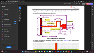

  • Does TI have PCB design files for racetrack sensor 2 layer with shielded routing? From below picture I just need 1 racetrack sensor for my testing.
    Since my intended application would be to detect leg wound swelling, the sensor placement on the leg bandage would be curved. A memory foam spacer would work in this situation. I guess that the memory foam would be glued to the sensor. I will use copper tape as a conductive target.
    -kel
  • Kel,
    You may be interested in the LDC Coil EVM, which provides many coils that you can test with.
    https://www.ti.com/tool/LDCCOILEVM
    To generate your own coils, you can use the Webench tool below.  This does not generate the shielded routing. You would need to implement this in your design.
    https://webench.ti.com/wb5/LDC/#/spirals
