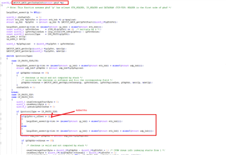

  • Hi Laurentiu,
    I had this kind of issue some months ago trying to send UDP datagrams larger than the 1500 bytes MTU. I'm don't know if this will help you but for your information I had to patch the following SDK file because the UDP header size check made my transmission fail. For an UDP datagram, the header is 20 bytes large but if the datagram is fragmented because larger than the MTU, the UDP header is not repeated in all the fragments, just the first one. So the check failed. Now, with the patch I added, I am able to send a 15kbytes datagram. I don't know if this is the right way to proceed but this can help as a mitigation.
    <MMWAVE_SDK_INSTALL_PATH>\source\networking\enet\core\lwipif\src\lwip2lwipif.c
