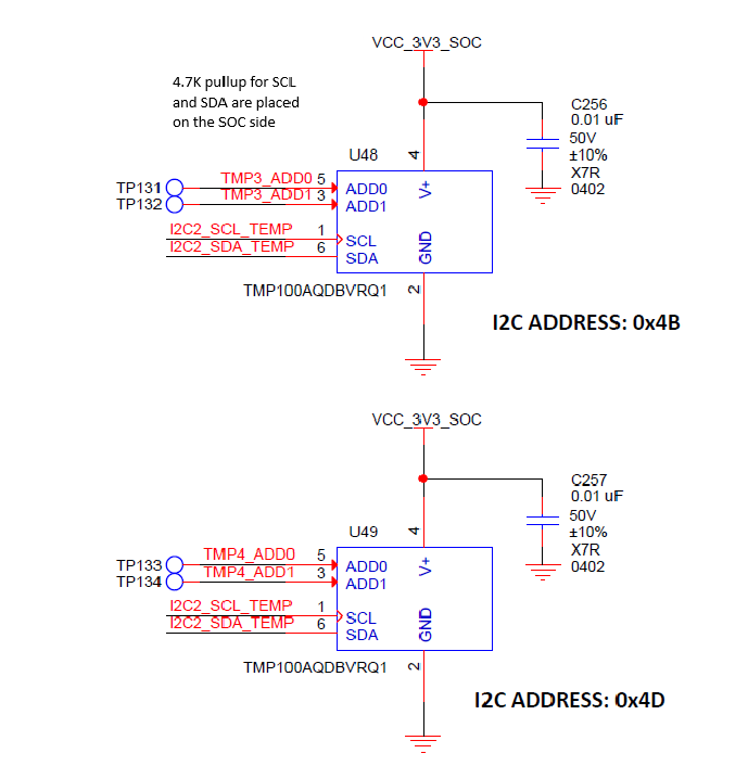

In our design we would be using TMP100AQDBVRQ1 IC ,we have created design can you please review it.

Hi Tirthal,
I don't see any issues with your design. However since I can't see what you connected to the address pins, just make sure they are connected appropriately so you get the desired I2C address (see table below).

Hi Sakeenah,
Please find the image Below :
Let me know your feedback.!

Hi Tirthal,
Sorry for the late reply. Yes, the addr pin connections look correct.
