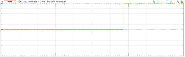

  • Hello Hamza,
    Thank you for your patience. I tried this out with an HDC2080 and an Arduino controller connected to an oscilloscope and was successfully able to see the interrupt pin go high upon data-ready status.
    I configured the registers in the following order using the values you selected above:
    1. Interrupt Configuration Register (0x07) -> 0x80
    2. Measurement Configuration Register (0x0F) -> 0x00
    3. Configuration Register (0x0E) -> 0x56
    (100 ms delay)
    4. Configuration Register (0x0E) -> 0x01
    I also noticed in your responses above that you are configuring register 0x70 to 0x80, the Interrupt Configuration Register address should be 0x07.
    Harry
