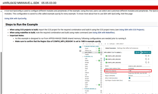

Due to insufficient memory, I have used shared memory in my project.
I configured `SH_MEM_CONFIG` to 3 (and also tried setting it to 1);
and the Region Size of `CONFIG_MPU_REGION1` is set to 1MB.
I have allocated part of the `.text` section to use the memory space from `0x00480000` to `0x0049FFFF`.

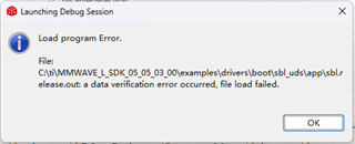

However, when debugging with CCS, I encounter a verification error.
Could you please advise how I can debug my project using CCS? I have already configured everything according to the SDK documentation.

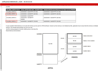

    According to the SDK documentation, in order to debug the **shared memory example** program using CCS,
    the configuration option **SH_MEM_CONFIG** needs to be set to **3**, and **CONFIG_MPU_REGION1** needs to be set to **1MB**.
    I have verified that these configurations have already been applied in the shared memory example provided in the SDK.

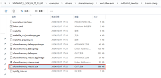

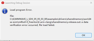

    However, when I use CCS to debug the pre-built **sharedmemory.release.out** file from the SDK, I still encounter the following error:
    In contrast, when I debug other demo programs using the same method, no such error occurs.
  • Hi Chris,
    Can you try flashing it instead of Loading the out file via CCS?
