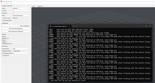

IWRL6432AOPEVM: Radar Toolbox's Industrial Visualizer not working
Part Number: IWRL6432AOPEVM
The Radar Toolbox's Industrial Visualizer is not working with my IWRL6432AOPEVM, even after following all the steps mentioned in the Motion and Presence Detection Users Guide.
I am getting the following error:
ERROR [gui_parser.py:189] ERROR: No data detected on COM Port, read timed out
ERROR [gui_parser.py:190] Be sure that the device is in the proper SOP mode after flashing with the correct binary, and that the cfg you are sending is valid
I have ensured that the EVM has been flashed and then set to functional mode.

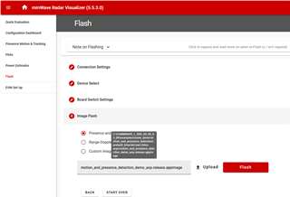

  • Yes, I am using the C:\ti\MMWAVE_L_SDK_05_05_03_00\tools\visualizer\visualizer.exe to successfully flash the C:\ti\MMWAVE_L_SDK_05_05_03_00\examples\mmw_demo\motion_and_presence_detection\prebuilt_binaries\xwrL64xx-aop\motion_and_presence_detection_demo_aop.release.appimage image.

    You need to load the configuration via Industrial Visualizer. Are you performing that?
    There will be a button to select, start and send configuration in the industrial visualizer gui.
  • Yes, I am using and sending the C:\radar_toolbox_3_10_00_05\source\ti\examples\Industrial_and_Personal_Electronics\Motion_and_Presence_Detection\Motion_and_Presence_Detection\chirp_configs\height_based_detection\xwrl6432aop\sit_stand_detection.cfg configuration file through the Industrial Visualizer GUI.
    That's when I get the error:
    I have also ensured that the EVM has been power cycled and set to functional mode.
    In the picture attached as part of the thread, i can see that the config is not loaded.
    Can you try flashing prebuilt binary present in the radar toolbox and send the configuration via industrial visualizer?
  • The picture is for reference only.
    I have also tried doing what you mentioned, but I am still getting the same error.
    Can you follow these steps once?
    1. Set device to flashing mode and press reset button.
    2. Flash the binary present in the following dir. (radar_toolbox_3_10_00_05\source\ti\examples\Industrial_and_Personal_Electronics\Motion_and_Presence_Detection\Motion_and_Presence_Detection\prebuilt_binaries)
    3. Set device to functional mode and press reset button.
    4.Open Industrial Visualizer, select device and connect COM ports.
    5.Select this configuration
    (radar_toolbox_3_10_00_05\source\ti\examples\Industrial_and_Personal_Electronics\Motion_and_Presence_Detection\Motion_and_Presence_Detection\chirp_configs\height_based_detection)
    6. Click start and send configuration.
    I tested these steps and it's working for me fyi.
