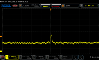

    I used two BOOSTXL-TUSS4470s to exchange signals. In this system, while one BOOSTXL-TUSS4470 acts as a transmitter, I checked the signal transmission by measuring the Vout pin of my other BOOSTXL-TUSS4470 with an oscilloscope. I saw 2 different pulses in the oscilloscope image. I didn't understand why the first pulse was generated while the second pulse was the signal I was sending. I verified that the second pulse was the signal I was sending by putting a barrier between the two transducers. When I put the barrier, the second pulse disappeared while the first pulse was still present. When I stop transmitting from my transmitter BOOSTXL-TUSS4470 board, both pulses are gone. What do you think could be the cause of this.
  • Metin,
    On the transmitter, how many pulses are you sending?  If you send more pulses, do you see any affect on what is received?
  • Eddie,

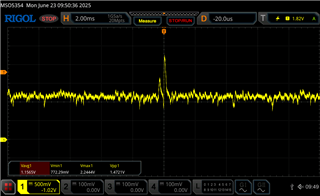

    I am sending 40 pulses and yes I can see the effect of pulses on received signal. I tried to adjust parameters to fix but notting changed.
    Actually, when I was testing a while ago, I was only powering the MSP-EXP430F5529LP via USB. Then I connected power to the jack input to power the external drive, but I forgot to remove the main to 5V jumper at J6 and the MSP-EXP430F5529LP burned up. When I checked, there was no problem with the BOOSTXL-TUSS4470 board. I bought a new MSP-EXP430F5529LP and when I reconnected it I noticed this situation. Now I tested it again and this situation persists but when I transmit from the other BOOSTXL-TUSS4470 I don't see this echo but the voltage of the received signal is very low. Could this situation because the TUSS4470 has damaged? The external voltage I applied was 24V. In this case, the TUSS4470 should not be damaged. I cannot understand the cause of the problem.
    The received signal at other BOOSTXL-TUSS4470 is attached. How can I check if TUSS4470 damaged?

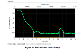

  • Metin,
    The expectation is that the echo signal should look like the image below.  I am not sure what could be causing the pulse you see in your first device outside of a damaged device.
