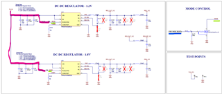

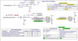

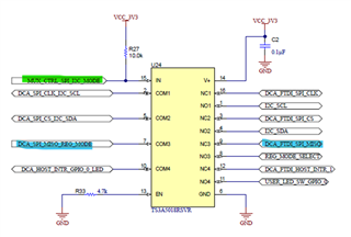

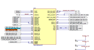

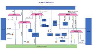

  • 1. The board schematic has a gazillion multiplexers. It makes very hard to track signals without breaking some other signals that are used by the code. What pins should I use for PWM? What switch positions should I set? Where will my PWM signals come out so I can make connection to them? Do I need to do any HW modifications?
    The EVM wasn't designed with this in mind, so your milleage may vary. The fact that the SYSCONFIG has assigned E3 & E4 bodes well however.
    The Schematics for the EVM will be key here. The best practice is to identify what signals are being used and see how they are routed. Looking at the schematics, I can see that E3 and E4 are part of the SPIA port. The next step is to look at the Mux Block Diagram, which is page 2 of the schematics. From there, we can see what the signal path will be for the SPIA port through the MUXs. The MUX BD convieniently also indicates the appropriate switch settings to control the MUXes. Further, I can see that the SPIA port MISO and MOSI connect to the J2 header port. E3->J2.6 and E4->J2.5
    The REG_MODE doesn't need to be driven. If the S4.3 switch is flipped, the radar will no longer be able to control the DCDC switching mode through the Q3  FET by pulling the signal low.. The MODE pin of the DCDC's is pulled up, so therefore, this will default the DCDC to PWM mode. If you are tracking power consumption, you may see some increase in consumption, since the DCDCs won't go into PFM mode during periods of low consumption. Based on this, there is no concern of the DCDC modes flipflopping.
    The schematics are searchable PDFs, so to confirm all these signal paths for you, I just CTRL+F'ed through. I took some screen caps and tried to color code the signals to make it easier to follow. If you need to maintain other signals, than you can use this same process to determine the best path forward.
    All the images are below. First the top level MUX BD, and then a tracing of the signal path, the MUX control tables, and then finally the DCDC Mode control.
    The schematics are easily located on the IWRL6432AOPEVM tool page on ti.com. I've linked it here for ease of use: https://www.ti.com/lit/zip/sprr496
    I hope this is useful and answers your MUX questions! Thanks!
