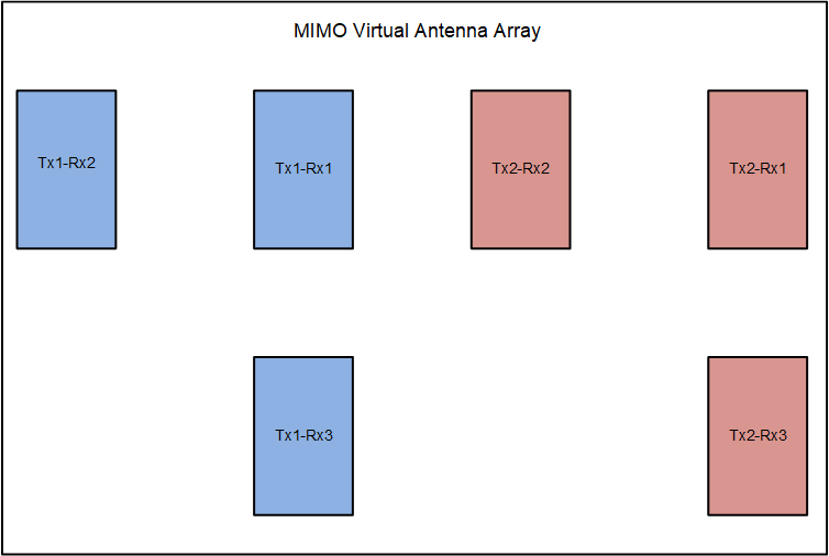

    I am working on a proximity sensing application.
    Since the virtual antenna array has different pattern, not square or rectangular size i had a confusion
    about where the 0 degree of FOV or boresight will be on the surface of the device.,
    I understand from your reply that the center of FOV is at the center of top surface of the device.
    How much angular resolution can be considered for IWRL6432AOP if we use 2TX and 3RX antennas.
    whether we can take , angle resolution=2/(2*3) or
    Whether we have to partition the antenna for azimuth and elevation angle resolution
    like azimuth angle resolution=2/Ntx and elevation angle resolution as 2/Nrx,
    Please clarify the angle resolution for this device.
    Thank you.
  • Mahalakshmi,
    Above attached is the virtual antenna array for the IWRL6432AOP. It has 4-elements in the azimuth plane and 2-elements in the elevation plane. Hence, in azimuth plane it would give angle resolution of 2/4 * 180/pi = ~28 degrees, and in elevation it would give 58 degrees.
