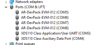

I'm trying to experiment with raw ADC capture using AWR2243BOOST and DCA1000EVM evaluation boards.
I've installed mmWave Studio 3.0.0.14, FTDI drivers, Microsoft Visual C++ 2013 Redistributable package, and MATLAB runtime, as described in file:///C:/ti/mmwave_studio_03_00_00_14/docs/mmwave_studio_user_guide.pdf
But I can't get to mmWave Studio GUI because of an error:

  • Hello Artem,
    Thanks for reaching out. The issue is likely due to a missing or incomplete MATLAB runtime. Could you please confirm you have MATLAB runtime R2017 or later is properly installed? if not, please re-install then reboot and try again. Let us know if any issue persists.
    Aydin
  • I did follow instructions from Quick Start Guide (SPRUIK7 – May 2018, found in ti/mmwave_studio_03_00_00_14/docs/DCA1000_Quick_Start_Guide.pdf) and installed MATLAB runtime with MCR_R2015aSP1_win32_installer.exe.
    According to your suggestion, I did uninstall R2015aSP1. Then installed both MCR_R2017b_win64 and MATLAB_Runtime_R2025a_win64 runtimes.

  • Hi Artem,
    Could you check if you have the path specified in the system variables, please check the following Set MATLAB Runtime Path for Deployment - MATLAB & Simulink
    Aydin
  • That's it!
    I reinstalled MCR_R2015aSP1_win32_installer.exe
    Added "C:\Program Files (x86)\MATLAB\MATLAB Runtime\v851" to PATH.
    And it worked Slight smile
    Thank you for the help!
