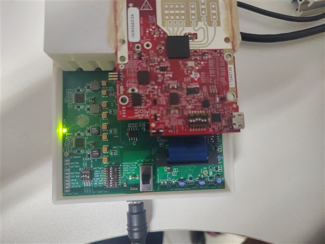

In the past, when my DCA1000 was operational, the row of lights on the DCA1000 would all light up after power was applied. After about 3 to 5 seconds, the other lights will go out, leaving only the power light remaining on.
And as soon as the power is turned on, the radar IWR6843ISK connected to DCA1000 will faintly light up some of its lamps.
But now, after powering on the DCA1000, my board only lights up the power indicator light, but none of the other lights come on. Even the radar lights connected to it would not light up.
I was unable to establish communication with DCA1000 using the previous method either.
.\DCA1000EVM_CLI_Control fpga DCA1000.json
FPGA Configuration :
Timeout Error! System disconnected
Does this mean that the DCA1000 is broken?
