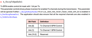

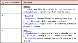

The information I provided earlier is inaccurate, this is possible with IWRL6432.
See this description of c_ChirpTxMimoPatSel from the ICD ({MMWAVE_SDK5_INSTALL}\firmware\mmwave_dfp\docs\mmwave_dfp_interface_control_document.pdf), if this is set to ‘0’ then TX enable and BPM enable are controlled by h_ChirpTxEnSel and h_ChirpTxBpmEnSel.
And with h_ChirpTxBpmEnSel it is possible to match the same phase across TX by setting the same value for bits 0 and 1 (0 or 0x3).
