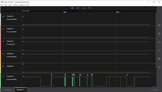

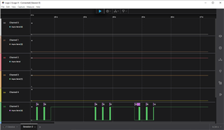

  • Well, it behaves differently.  I think its still angle influenced.  It can generate pulses even if I dont press a button.  Also, the int pulses come in bursts and then stop.  Those triple pulses are when I have the button held down continuously.  Maybe I have the int_mode and related configured incorrectly?  Here is the scope trace of the int pin:
    and here is my relevant register dump
    Again, thank you for your help!  Rare to get this kind of rapid response/support!
  • Hi Larry,
    To use the unipolar switch mode, INT_MODE should be set to 5h. So INT_CONFIG_1 should look something like 0x14.
    ~Alicia
