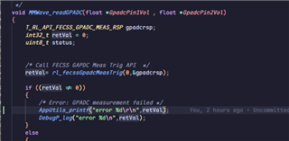

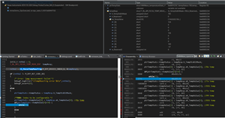

Hi TI experts,
While developing a new application for our custom board, we observed inaccurate temperature sensor readings.
Specifically, the temperature values retrieved via rl_fecssTempMeasTrig sporadically jump from approximately 40°C to around 130°C within a 60ms window – despite stable ambient conditions.
The relevant code section and variable states are captured in the attached snapshot.
After we re-start the sensor, the temperature change to normal.
Have you encountered similar issues? Could you provide recommendations for in-depth debugging?

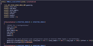

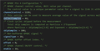

  • Hi Kundan,
    I configure the GPADC reading parameters by MMWave_enableGPADC. And the parameters are all you mentioned before.  So I do not measure the external voltage. I  just do not change the variable name.

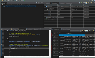

    Recently, we still try to change some code and reproduce this issue. After moving code RAM, we found the retVal of ADC is -1027(M_DFP_RET_CODE_RFS_GPADC_IFM_INVAL_SAMPLS). Do you know this error meaning? And which parameters will cause this error?
    Yongheng
  • Hi Yongheng,
    This is due to programming invalid number of collect samples field in GPADC config API. The Collect samples should be a non-zero number.

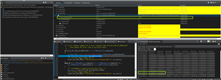

  • Hi Kundan,
    Are there any other reasons to cause this "M_DFP_RET_CODE_RFS_GPADC_IFM_INVAL_SAMPLS" issue?
    I check the GPADC configuration at IPC RAM and the value "0x820A470" is same with the code configuration when the issue occur.
    The first picture is IPC RAM and the second one is GPADC configuration from code.
