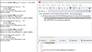

My customer tried to modify the power test to use Power_idleFunc to enter deep sleep mode like motion demo, but fail to continuously wake up from deep sleep mode.
#define SLEEP_TIME_TICKS (1000)

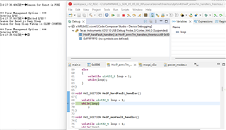

I tried similar modification and found the device has waken up from deep sleep mode, but then enters hard fault after 2nd time wake up. Pls find snapshot below.

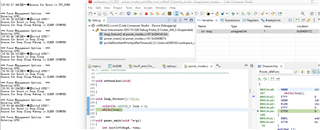

I tried to add a while loop before Power_disablePolicy() (just wake up from deep sleep mode) and connect CCS to change the value of loop from 1 to 0, then the code can enter deep sleep mode for multi times.

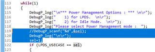

I also tried to only fix the sel=1 (add line 121) and comment 119 line in the default power test code (no other changes), but also saw hard fault.

    The problem is solved by changing UART from interrupt mode to polling mode. I checked motion and presence detection demo and found it also uses uart pollint mode. Would you pls kindly advise why UART interrupt mode will cause Hard fault?
