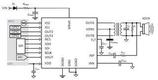

    I use the typical application diagram of TUSS4470, not TUSS4440 as described in  the previous post. Where Rinp=3k, Cinp=330p, driving frequency is 88kHz, pulse number is 16

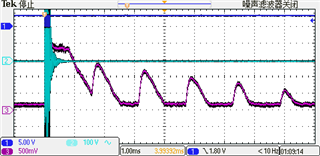

    When I put the ultrasonic transducer int he air, the figure on the oscilloscope is as follow,
    Ch1 is the trig pulse from microprocessor, Ch2 is the voltage applied to the transducer, Ch3 is Vout of  TUSS4470.
    On this situation, TUSS4470 acts magically, although almost noting can be found on CH2 by eye,  Vout  tells the actual distance.

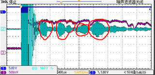

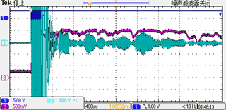

    When I put the  transducer in water, as it is designed for,  the figure on the oscilloscope is as follow, while each channel is defined as before
    Ch1 and Ch2 behave almost the same as in the air, except echo can be observed on Ch2 by eye. But no echo pulse can be found on Vout.

    From your second plot on CH2, are those fluctuations (circled below) echoes or just noise? I would recommend decreasing the number of pulses and disabling the last stage of the log amp to help reduce any noise that you may be seeing.

    I think the fluctuations circled on CH2 are echoes.
    I have decreased the  pulse number to 8, and disabled the last stage of the log amp, but the result haven't improved, no applicable information can be seen on TUSS4470's Vout.
