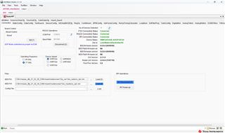

So the LATTICE FPGA is only for sending DATA. I have an issue with radar power up despite the presence of firmware BSS radar. How can i fix that ?
Thank you,
Correct.
The BSS FW version is not looking valid. So, something went wrong in loading the BSS FW or the steps before.
Shailesh
I followed all the steps except the one concerning LUA, It's important to execute command LUA, it's important for what ?. this is my page of configuration.
