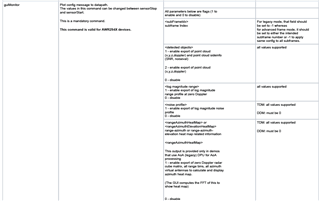

  • Hi Arie,
    There is no issue with the Python visualizer. I noticed that transmission of detected objects is disabled in the guiMonitor CLI command.
    You can use the following CLI command "guiMonitor -1 2 0 0 0 0 0" to transmit Object Data over UART.
    Even when you use the demo visualizer, you wouldn't have observed the plot showing the detections (i.e 3D plot with x,y,z coordinates of the objects).
    Samhitha
