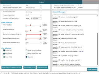

IWR1843BOOST: loading errors for configuration files from mmWave demo visualiser
Part Number: IWR1843BOOST
Other Parts Discussed in Thread: DCA1000EVM,
1. Currently iam using the IWR1843boost without the DCA1000EVM, I'm trying to save the configuration file from demo visualiser and trying to upload the same configuration file  in the plot section of the demo visualiser, when iam doing so, im getting different errors for the same file, i have not edited the file, the same saved file when  uploading multiple times, give different error for the same file, i want to understand how to upload the custom conifg files to the demo visualsier? for this regards if you could suggest any visualiser which can take custom config files and show the processed outputs? please
2. Are there any resources to visualise the stationary and moving object, vehicle detection for a range of 40 meters, 40km/hr, range resolution of 0.3 meters to 0.4 meters, tried traffic monitoring, but not satisfactory results were obtained,
