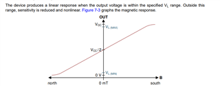

  • as per testing below test result which does not match with graph above
    sensor is powered from 5V
    Strong south pole output is 0.1 V
    Strong North pole output is 4.99V
  • Hi Sagar,
    Figure 7-3 is correct. Due to the polarity of the sensor, the device will treat the south pole of the magnet as a positive value and the north pole of the magnet as a negative value.

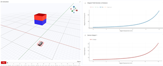

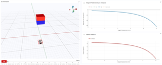

    What could be happening is that either your sensor is flipped, similar to the image below, or the polarity of your magnet is inverted.
    As shown in the simulation below, as the south pole of the magnet gets closer to the sensor, the device output increases.
