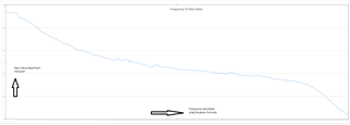

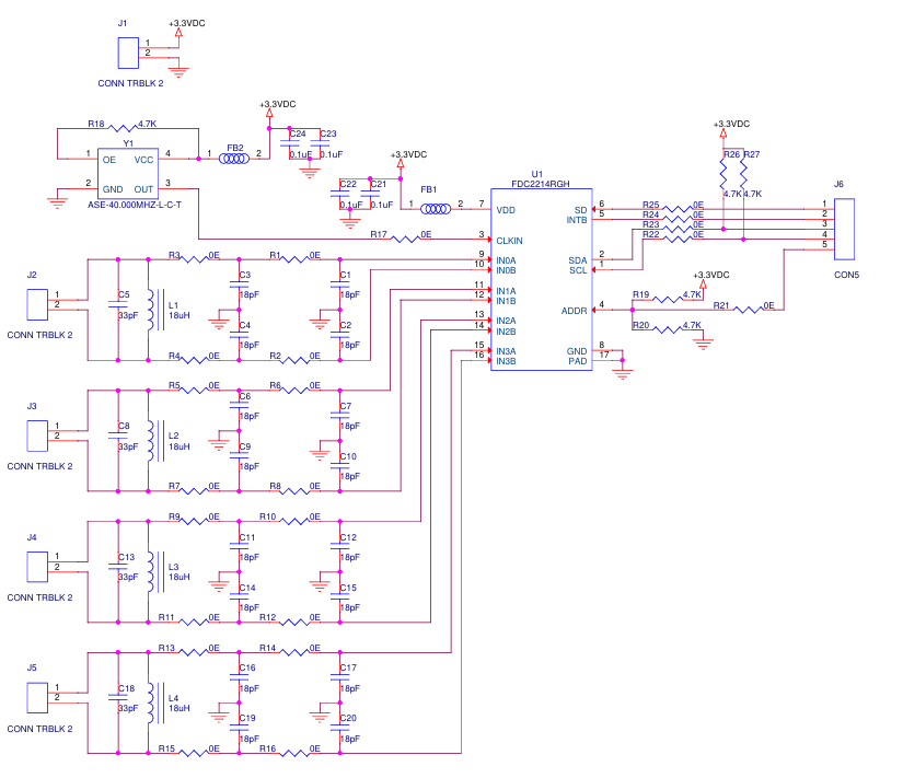

We want to use the FDC2214 for a liquid level sensing application and have some questions regarding its performance over long cable lengths.
Application Setup:
  • Sensor type: Capacitive sensor (Level Sense)
  • Cable used: 20-meter RG-188 coaxial cable
  • Measured capacitance:
    • Total capacitance (sensor + cable): ~2.3nF
    • Cable-only capacitance: ~1.9nF
    • Capacitance variation from sensor: ~0.4nF (i.e., the actual capacitance)
Questions:
  1. Can the FDC2214 reliably detect a ~0.4nF variation when the fixed cable capacitance is ~1.9nF?
  2. Are there design guidelines or precautions we should consider in this setup (e.g., shielding, guarding, excitation current settings, sensor frequency)?
  3. Will such a high baseline capacitance (due to cable) affect resolution, stability, or linearity, and how can we compensate or calibrate for it?
  4. Please refer to the attached schematic and advise on improvements if needed.
We would greatly appreciate any guidance or reference material specific to long-cable capacitive sensing with the FDC2214.
