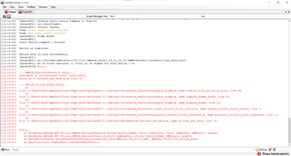

I am using DCA1000EVM and AWR2944EVM together. After following all the steps from the DCA1000 training video (https://www.ti.com/video/5827389052001), I got the following error after clicking "postproc" on mmwave studio. Would anyone know how to fix this?

    Can you please share the full log?

  • Please find it below:

    I do not see where you are connecting to the DCA1000 in your log. You need to connect to DCA1000 after you setup the datapath and frame config.

  • Please see below:

    [14:43:21] [RadarAPI]: ar1.ProfileConfig(0, 77, 100, 6, 60, 0, 0, 0, 0, 0, 0, 0, 0, 29.982, 0, 256, 10000, 2216755200, 0, 48, 0, 0, 0)
    [14:43:21] Status: Failed, Error Type: PF_RX_GAIN IS NOT WITHIN [24, 52] dB OR PF_RX_GAIN IS AN ODD NUMBER
    [14:43:22] [RadarAPI]: ar1.ChirpConfig(0, 0, 0, 0, 0, 0, 0, 1, 1, 0, 0)
    [14:43:22] Status: Failed, Error Type: IF THE PROFILE CORRESPONDING TO PROFILE_INDEX IS NOT DEFINED

    [14:43:24] [RadarAPI]: ar1.FrameConfig(0, 0, 8, 128, 40, 0, 1)
    [14:43:24] Status: Failed, Error Type: CHIRP USED IN THE FRAME IS NOT CONFIGURED BY AWR_CHIRP_CONF_SET_SB

    It looks like I see many errors in your logs. You need to correct these, the error is telling you what is wrong.
    Please try to power cycle the boards, and repeat it with the corrected APIs which do not give any errors. Then, please share a full log from start to finish which does not include any errors returned by the APIs.
    Adrian
    I followed your suggestions and was able to successfully troubleshoot the issue. Thank you so much for your help!
