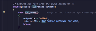

We want to know how to configure the I2C rightly.
Currently, we configure the I2C peripheral by TI system configure that bit rate is 100KHZ.
We found that the internal clock is 4MHZ when the bit rate is 100K based on the SDK code.
We check the L6432 Technical Manual Guide, the internal clock should be the Module Clock.
But the Module clock must be between 6.7M and 13.3M. We want to know which is right? Can we configure the I2C to 100KHZ?
