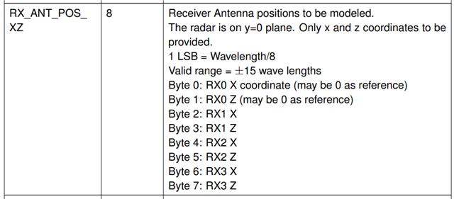

2.How are tsArgs.rxAntPos [i]. antPosX and tsArgs.rxAntPos [i]. antPosZ defined and set in the test source? Is it necessary to match the antenna layout on the RF board?

    2. Please refer to table 5.75 in the ICD (mmwave_dfp_02_02_04_00/docs/mmWave-Radar-Interface-Control.pdf)
    The RSS is not active in test source mode so it is technically not necessary to match the antenna layout on the RF board, but it would be useful to for testing purposes.
