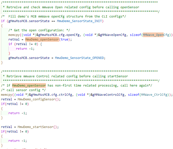

Please help me to check the root why I get RF Error
from following:
Bolong
Could you please provide me with more context.
What demo are you using? SDK?
What configuration file are you using?
What are the steps you have actually taken to run this?
Gabriel
D:/ti/mcu_plus_sdk_awr294x_09_00_00_15
D:/ti/sysconfig_1.19.0
D:/ti/ccs1260
mmwave_mcuplus_sdk_04_06_00_01
DDM type

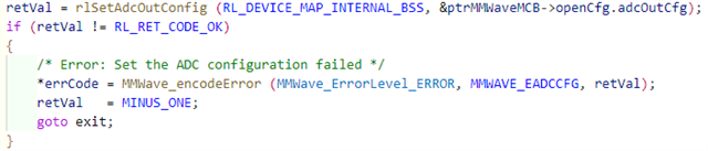

Because I want to trace error as following:
Error: mmWave Config failed [Error code: -3110 Subsystem: 93]
What is the error means?
Can I compiler ti/control/mmwavelink for
That error message is triggered when the config one has inputted is invalid. Just to double check, are you able to run the demo when you use the original config.
