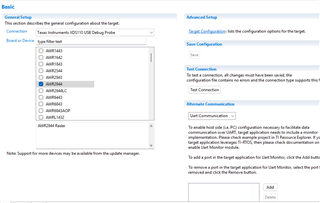

I want to debug AWR2944P application using CCS by when I create a .cxml target configuration file, gthe choic AWR2944P is nowhere to be found.
How to get it?
BR,
Adrien
Hi Adrien,
AWR2944P is supported in the newer version of CCS i.e. v20 onwards.
Shailesh

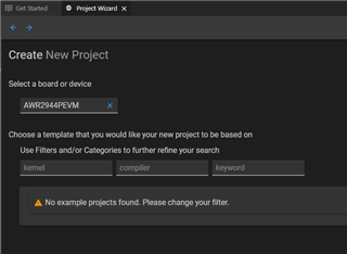

Thank you for your reply. I tried to create a new project with CCS 20.0.2.0 for the AWR2944P EVM but I cannot:
Is there a way to create the project in an other way?
BR,
Adrien
Hi Adrien,

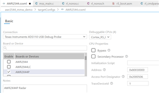

I see that the SDK does not come with a ccs example for AWR2944P as of now. For time being, can you just edit the AWR2544.ccxml (search for this) and change the device to AWR2X44P? Let me know if you face issues with this.
Shailesh
Hi Shailesh,
I have been able to play my R5F application with the debugger the editing the AWR2544.ccxml.
Now, I would like to use the full CCS v20+ IDE to continue developping my app with the AWR2944P. The mitigation you provided just give me the AWR2544 demo in the workspace but I want my exisiting code instead, for both R5F and C66 targets.
How can I proceed?
