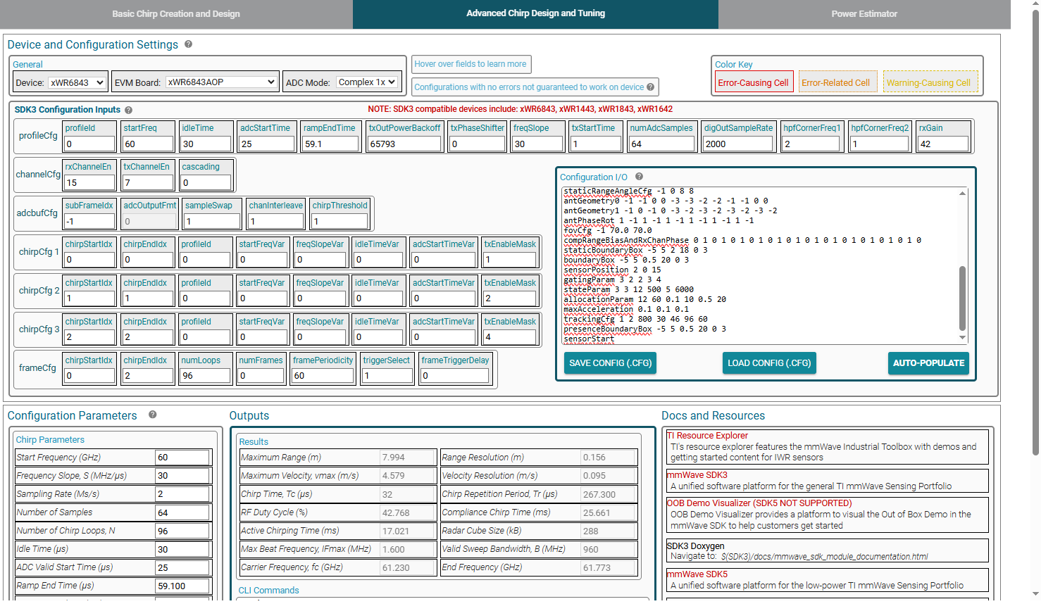

Also, can anyone tell me what software is being used to obtain sensor metrics based on the .cfg file shown in the previous post? That tool looks quite helpful.

    I would like to use the software shown in the image to try to reach the desired metrics for my application, but I don't know what it is. where can i found it?
    https://dev.ti.com/gallery/view/mmwave/mmWaveSensingEstimator/ver/2.5.0/
    This is how you can see the view in the image.
    You need to change the frequency slope - right now it's set to only detect at 8m. I know you said you tried that, but the config you posted above is only for 8m.
    Do you not see the detection range change when you modify frequency slope?
