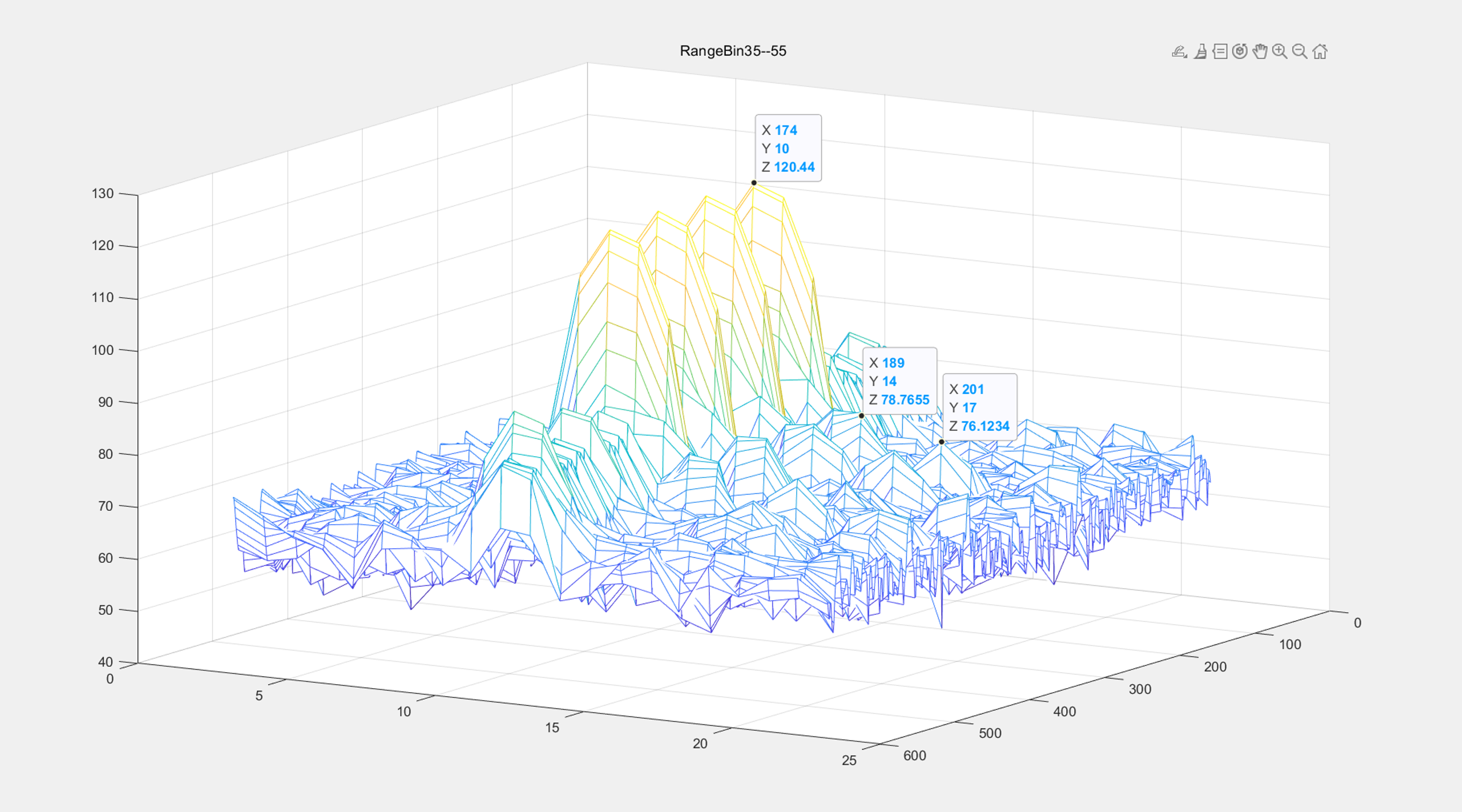

Hi TI teams:

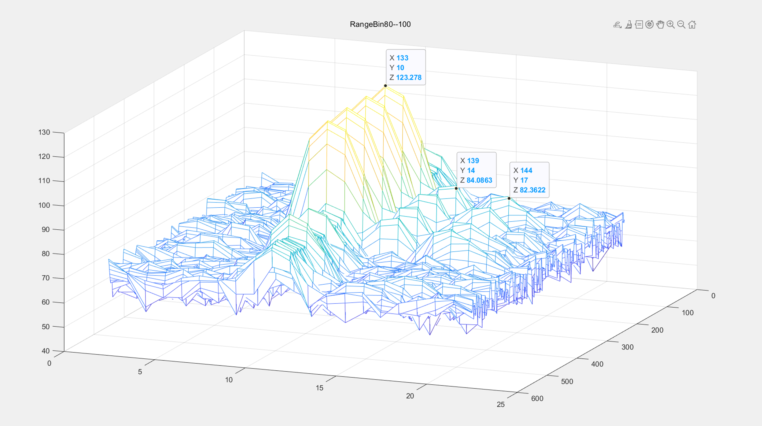

In the recent test, I discovered a problem existing in the spectrum,I used RTS to create a target of 30m-30dBsm-0Kph,This target can be correctly observed in the 2D spectrum
However, there will be false peaks at the 4th and 7th bins after this target peak,Even if the waveform configuration is changed and the scale of the RangeBin is adjusted, problems still occur at the 4th and 7th bins
eg:
The first waveform :The drawing coverage range is 35-55 bins(so the actual Bin is 45),There are false peaks at locations 14 and 17
The second waveform :The drawing coverage range is 80-100 bins(so the actual Bin is 90),There are false peaks also at locations 14 and 17
Regarding the above situation, In my understanding, if these two targets really exist in the environment, then as the slope of my waveform changes, their differences should also change together, rather than being fixed at 4 and 7 differences from the real targets.
This situation can be reproduced by using TI2944EVM and OOB-Demo, and by using adv-chirp-adv-frame for Profile.
From what aspects can I analyze this problem? Thank you!

  • Hi Minxi,
    If I understand correctly the X dimension is range, what is the other dimension, angle?
    I can see that there are additional peaks in the Y dimensions at offsets from the main peak. Then you changed the objects frequency by changing the slope, this will only affect the rangle (X) dimension, so your X values changed for all the peaks. Were you expecting the Y values for any peak to change with that?
    Please point out if I am incorrect.
    Shailesh
  • Hi Shailesh
    First, let's discuss this picture.,For this schematic diagram,The Y-axis represents RangeBin,and the X-axis represents DopplerBin.
    We used TX's phase shift.so,The X-axis will also experience a frequency shift.
    So, now we are discussing the issue in the dimension of distance. I changed the slope, and the Bin(Y) of the actual target, which was originally 35 + 10 = 45, changed to 80 + 10 = 90. However, the two small peaks following the actual target (Y = 14 and Y = 17) should also have changed, but the actual data did not change. Therefore, I suspect whether it is a problem caused by the radar system itself.
    I wonder if my description is clear enough.If you have any other questions that you don't understand, please feel free to contact me. Thank you very much.

  • Hi Shailesh
    Sorry, there was an error in my previous reply. The offset on the X-axis is due to the use of stepped frequency, not because of the phase shift of the antenna.
    Best Regards
    Minxi
  • Thank you for the clarification, Minxi.
    Can you confirm that you are not changing the sampling rate, only the slope between the two cases? And what is the sampling rate being used? What are the range processing steps, i.e. zero padding, windowing and fft?
    Can you try to see if the issue is visible when you don't do the stepped frequency? Just do a normal range-doppler spectrum?

  • Hi Shailesh
    I'm certain that only the slope and the start-frequency have changed between the two waveforms.
    Their sampling rate is 25000 ksps and the number of sampling points is 1000.
    When conducting 1D and 2D processing, a 60dB Chebyshev window was employed.
    Regarding the test of disable step frequency,I will reply after I have the test results.

  • Hi Minxi,
    So, if I assume you are doing a 1024 point FFT (please confirm), the 4 bins offset will mean 97kHz offset and 7 bins will mean 170KHz offset from the main tone. This does not match with any known spurs in the device as per the document: https://www.ti.com/lit/er/swrz102c/swrz102c.pdf. Do you see the spurs on only one side of the main tone, or are there peaks at -4 and -7 offsets too?
    Can you help us understand what object is present in the scene? Are there multiple objects present, do all the objects show these peaks? Can you experiment using a reflector and understand if it shows for all distances and for multiple objects?

  • Hi Regards,
    Now that the test on the step frequency has been completed, I will share the results with you.
    1.As you said, we will perform a 1024-point FFT. And the spurs on only one side of the main tone(+4 and +7 offsets)
    2.The peak value in the 2D spectrum is my set target, which is the 30m30dBsm0Kph target set by Radar target simulator.There is only this one goal.It is precisely because of such a target setting that the emergence of the two false peaks has caused us great trouble.
    3.After disabling the step frequency, the false peak still exists, but there is no offset in the Doppler dimension.
    The two pictures above show the result of turning off the step frequency.
    The two pictures above show the result of activating the step frequency.
    It doesn't seem to be the root cause.

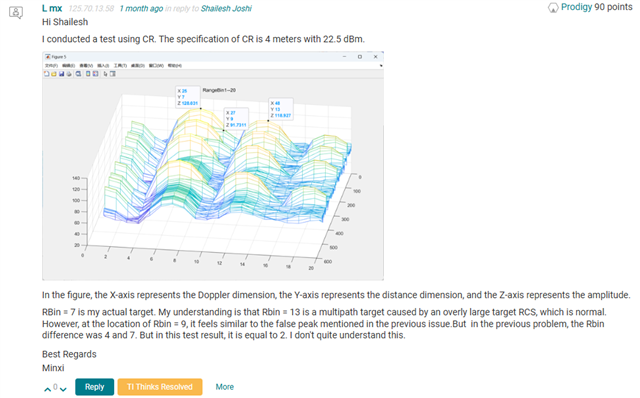

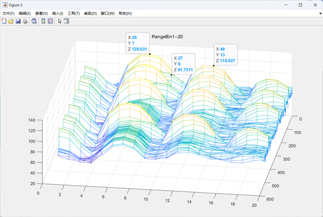

  • Hi Shailesh
    I conducted a test using CR. The specification of CR is 4 meters with 22.5 dBm.
    In the figure, the X-axis represents the Doppler dimension, the Y-axis represents the distance dimension, and the Z-axis represents the amplitude.
    RBin = 7 is my actual target. My understanding is that Rbin = 13 is a multipath target caused by an overly large target RCS, which is normal. However, at the location of Rbin = 9, it feels similar to the false peak mentioned in the previous issue.But  in the previous problem, the Rbin difference was 4 and 7. But in this test result, it is equal to 2. I don't quite understand this.
    Best Regards
    Minxi

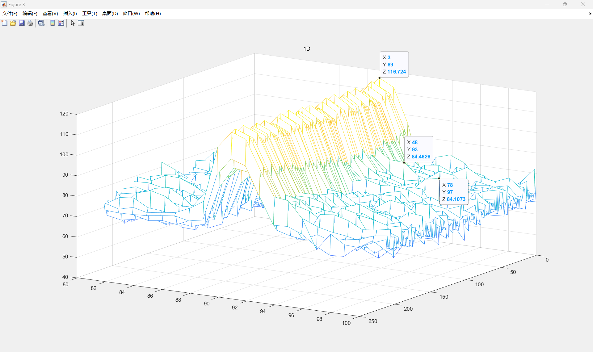

  • Hi Minxi,
    Can you see the spurs if you only perform range FFT and not Doppler? I am also not sure if you should see the peaks in doppler as CR is a static object, correct? Trying to see if the false peak is a processing artifact.
    On the RF side, this does not match with our expectation if the configurations are all valid. As indicated before, some invalid configuration of idle time, adc start time or ramp end time can also result in additional noise/spurs. Requesting again to confirm this as per your profile configuration, previously you have shared only TI profile configuration.
    Shailesh
  • Hi Shailesh
    This picture represents the result of range FFT. The X-axis indicates Chirp_num and the Y-axis indicates RangeBin.
    I understand that there are still the so-called false peaks that we have described.However, from the graph, it can be seen that not all Chirps exhibit this false peak clearly.
    For waveform configuration, we will illustrate it with the graphical results:

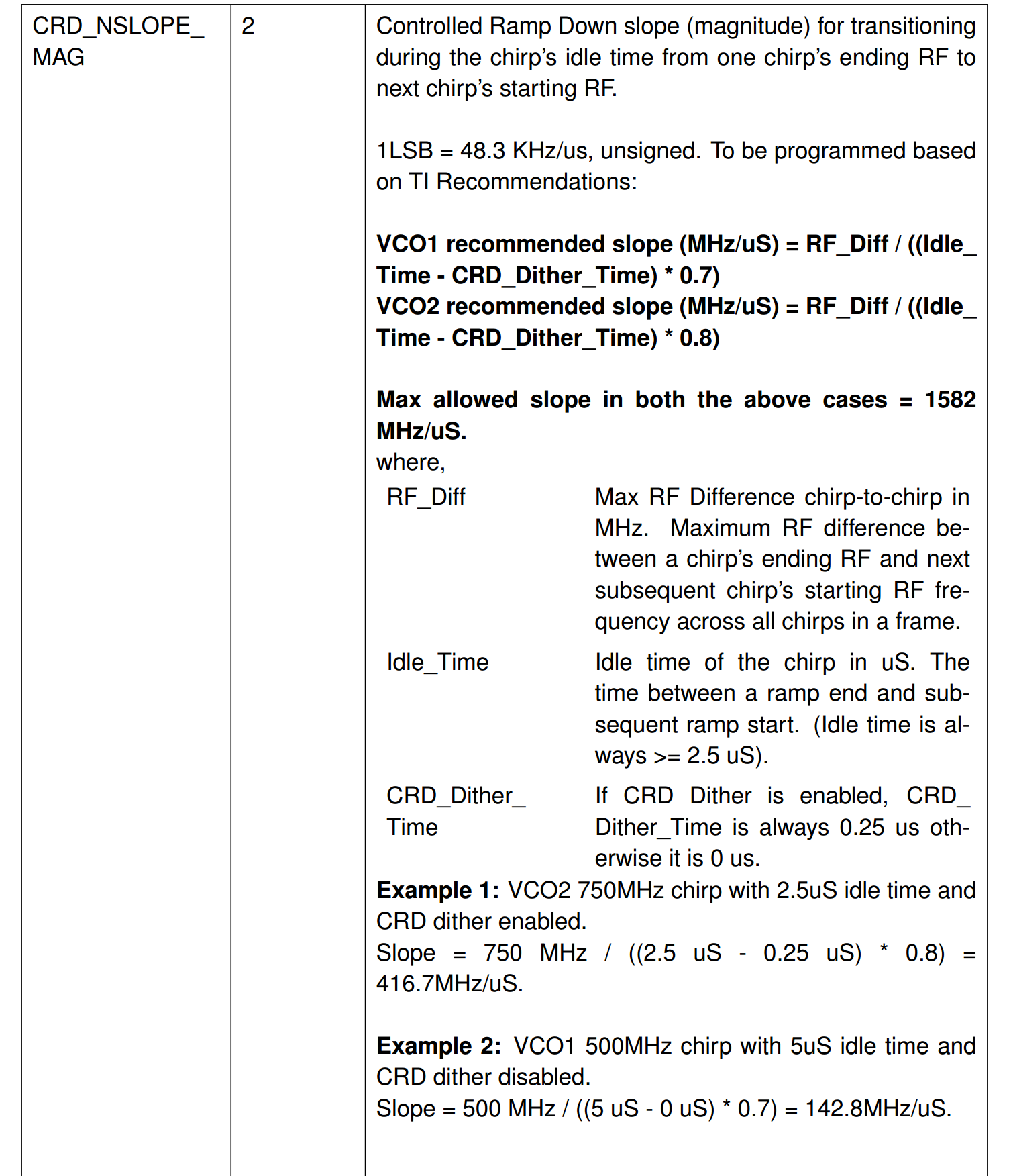

  • Hi Minxi,
    From your configuration, one possible issue I see is that the adc start time is little too less. Because of this there can some instability in the initial part of the time domain data. See if you can increase it by 2-3 microseconds more. If that helps, you can also try enabling the HPF_FAST_INIT feature which makes the initial part of the chirps more stable
    For CRD, please find the maximum NSLOPE across all the configurations and use that value. So, you need to find in which case the difference between end frequency of a chirp and the start frequency of the next chirp is maximum. If the idle time is also changing, then look for the max Rf_Diff/Idle_Time ratio.
    Shailesh

  • Hi Shailesh
    I have completed the tests, which involved setting ADC_Start_Time to 1.6 microseconds and 4.6 microseconds respectively. However, the test results are the same as the previous conclusions. There is no obvious difference in the spectrum.
    Can we have any other ideas in other areas?

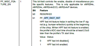

    Don't have many ideas on what it can be. Have you enabled CRD_Dither also, it can also help with the issue.
    Shailesh
  • Hi SHailesh
    Currently, I am not using CRD and the PF_HPF_FAST_INIT configuration in the profile. So, I will enable them next to see if it works.
    Meanwhile, I also discovered another function, INTER_CHIRP_JITTER_MITIGATION. However, it suggests that idle_time should be greater than or equal to 6us. But for our current waveform which has only 3.5us, doesn't this violate the requirement?
    Best Regards
    Minxi

    Let us wait for your CR experiments.
    Shailesh
  • Shailesh,
    Customer has ever tested with CR, and have same issue, details was feedbacked before as below figure.
    Customer said using the default bin and cfg in sdk4.7.0.1, it is able to see same issue, can u help have test and comment here, thanks.
    mmwave_mcuplus_sdk_04_07_00_01\mmwave_mcuplus_sdk_04_07_00_01\ti\demo\awr294x\mmw\profiles\ddm_awr2944\profile_advanced_chirp_advanced_frame_DDMA_awr2944.cfg
  • Hi Andy, in order to narrow down the source of the fake peaks, can the customer run and check the mmw demo with TDM instead of DDM? And report back whether the issue is still visible. This way we will know if this is an actual problem or a DDMA processing artifact.
    Shailesh
  • MX,
    Agree with Shailesh, suggest do few test to confirm it is DDMA related or not? Can test with TDM, or just enable 1TX for test.
    Also as u used on larger RCS with power up to 30dbsm at 3m, i think it would be the possible case, pls use small RCS or test at longer range up to 100m for try to confirm the cause.
    Andy
