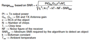

hi there,
i'd like to estimate range and rcs when playing around with radar configuration. since this is not calculated by the mmwave sensing estimator in the advanced tab, i'd like to do it my own via the formula given in swra553a.pdf.

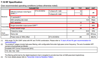

i spent some time now to get the required values but did not find all of them in the datasheets. for (Pt * Gtx) i'd assume 17dBm from the datasheet of IWRL6432AOP. is this correct?
but what i did not find were the values for Grx and NF. what values do i have to take here for calculation?
thank you very much for your help
