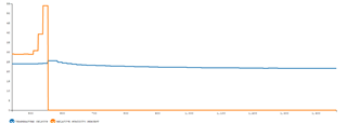

    The sensing element uses a polymer whose dielectric constant changes according to the ambient RH. It must be exposed to ambient air to properly measure RH. If a water drop occurs in the sensor cavity of HDC2x, then the RH measurement will suddenly spike then drop to 0%. It remains at 0% until the water is dried off. I copied an example graph from a little experiment I did with an EVM.
