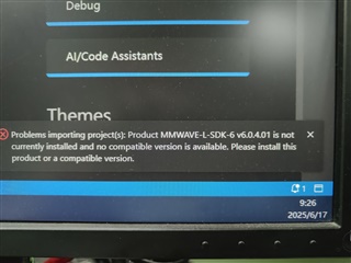

AWRL6844: I can't import the In-cabin demo CCS project base on AWRL6844
Part Number: AWRL6844
I want to import the demo project into CCS V20 from AWRL6844 InCabin Demos in Radar Toolbox-3.10.00.05, But there is a error that is showed in the following picture, but I have download the SDK-06-00-04-01 and put it in C:\ti. By the way, I have copied it in to the workspace path of CCS V20, but the problem is not solved. can you tell me the reason? thank you very much

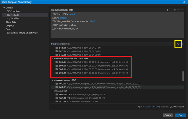

  • Hey Albert,
    Thanks for reaching out regarding this import issue. I would recommend double checking that the SDK is recognized by CCS. In the top-left corner of CCS, navigate to File -> Preferences -> Code Composer Studio Settings. Under General -> Products, you can see the products discovered by CCS automatically. You can trigger a manual refresh by clicking the circular arrow symbol which will check any product discovery paths again to see if any new packages are available.
    Let me know if this helps.
