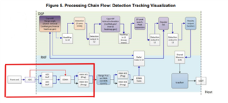

Hi TI,
May I know which part of the source code in "Overhead_3D_People_Tracking" or "mmwave_sdk_03_06_02_00-LTS" runs the ADC Buffer data collection to L1/L2 RAM?
Hi TI,
There are EDMA calls in the demo that accomplish this. They are set up in DPC_ObjDet_rangeConfig in teh out of box demo.
